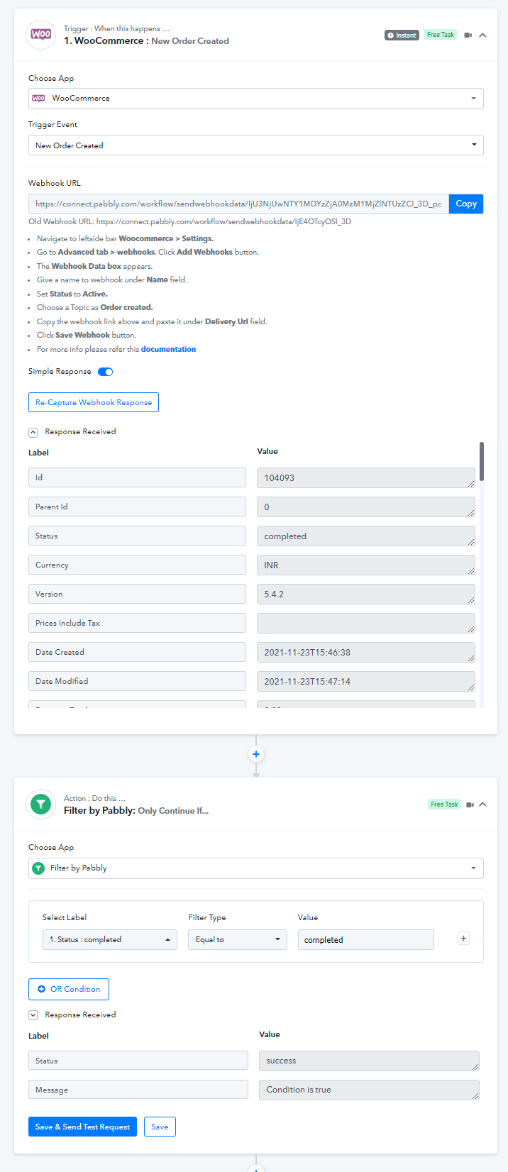

We have a number of flows which are triggered by Order Created in WooCommerce, and grant offers and also trigger automations. However, we only want these to run when the order has been paid for.
For that, you can use the filter action step which will only process the order which is completed.
E.g. -

Supreme
why I couldn't allocate the webhook to "Order Paid" in WC as it returns a similar JSON object to Order Created?
Since the status of the order always comes with the Status field already defined in the WC account.
So, you will be required to pass the exact text of the status which is meant for Paid for an order.
If it is coming Paid from your WC account then you can use it Paid as it is.

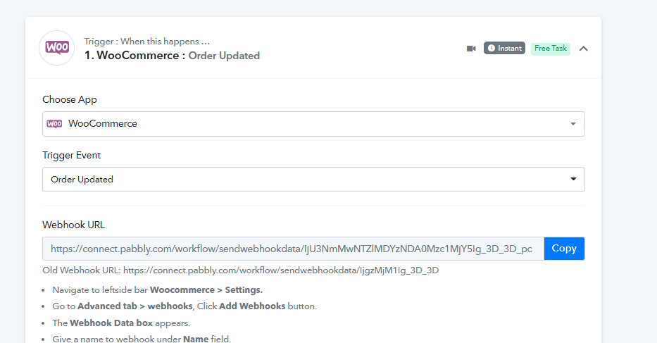

Supreme
Hey @Anastasia
If your order is getting updated after the pending status then you would be required to use another workflow with the trigger event "WooCommerce: Order Updated" which will then process your order only after getting successful payment.
