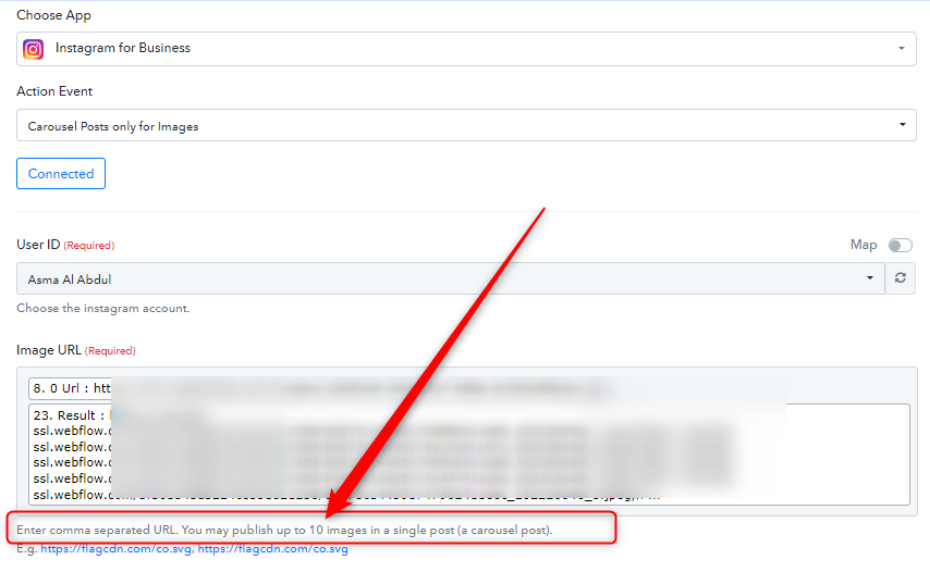

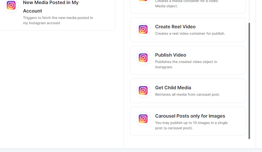

Please refer to the instruction text stated in the action step to confirm that a "carousel post" on Instagram is limited to a maximum of 10 images.
Yes, I did limit it to 10 images. See the image in my next reply. There are exactly 10 images numbered 0-9 which equals 10 images total. It's very frustrating when I post the exact workflow and step to review and you reply with a response that makes it seems like you are replying with a generic reply before actually investigating the issue.

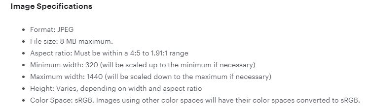

Can you please check the following parameters whether the images you are passing are in the format? Also, do check whether the image is supported in a single post.
I've seen this work with exactly the aspect ratio I'm using and these types of images. It works inconsistently. Where are the aspect ratios you've specific coming from? Instagram actually looks best with a square ratio of 1:1. It worked just fine for this post on Instagram here: https://www.instagram.com/p/ColaBbKNSL_/

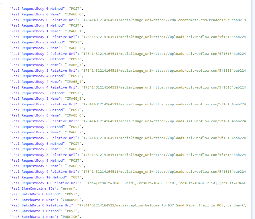

It has failed again.
Task History ID - IjU3NjcwNTY1MDYzMTA0MzU1MjZkNTUzNDUxMzY1MTY2NTQzNSI_3D_pc
Failed on step: ANDREW ST. HILAIRE - Carousel : Carousel Posts only for Images
I used only 10 images. I must have this working! The app is working fine later in the workflow for step called:
Succeeded on step: ASMA AL ABDUL - Carousel : Carousel Posts only for Images
Why does this work on one step and not on the other? Can you please fix this problem?
