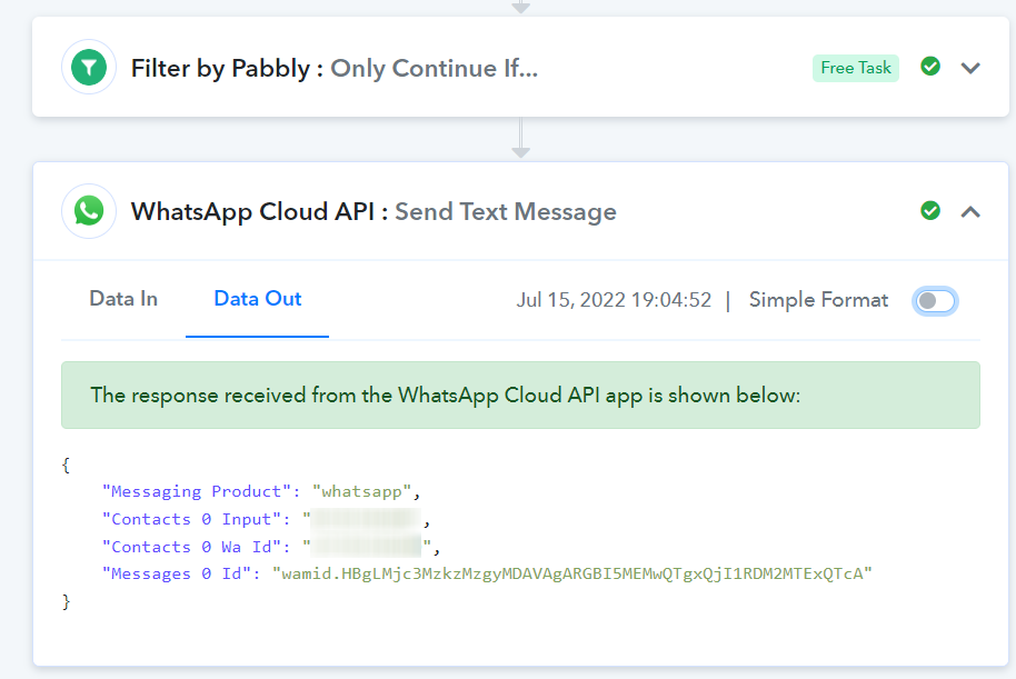

I am having the same issue as @Digital Tamila whereas my workflow is configured and the payload is picked up accordingly and filters are applied fine.
Issue comes about when the WhatsApp Cloud API sends text out. I get a successful response from the API service but no text is sent.
I have tried to change the WhatsApp CAPI configuration to send out an approved template message and this works fine.
However, when I am sending out an open text "Send Text Message" trigger. These are not delivered at all.

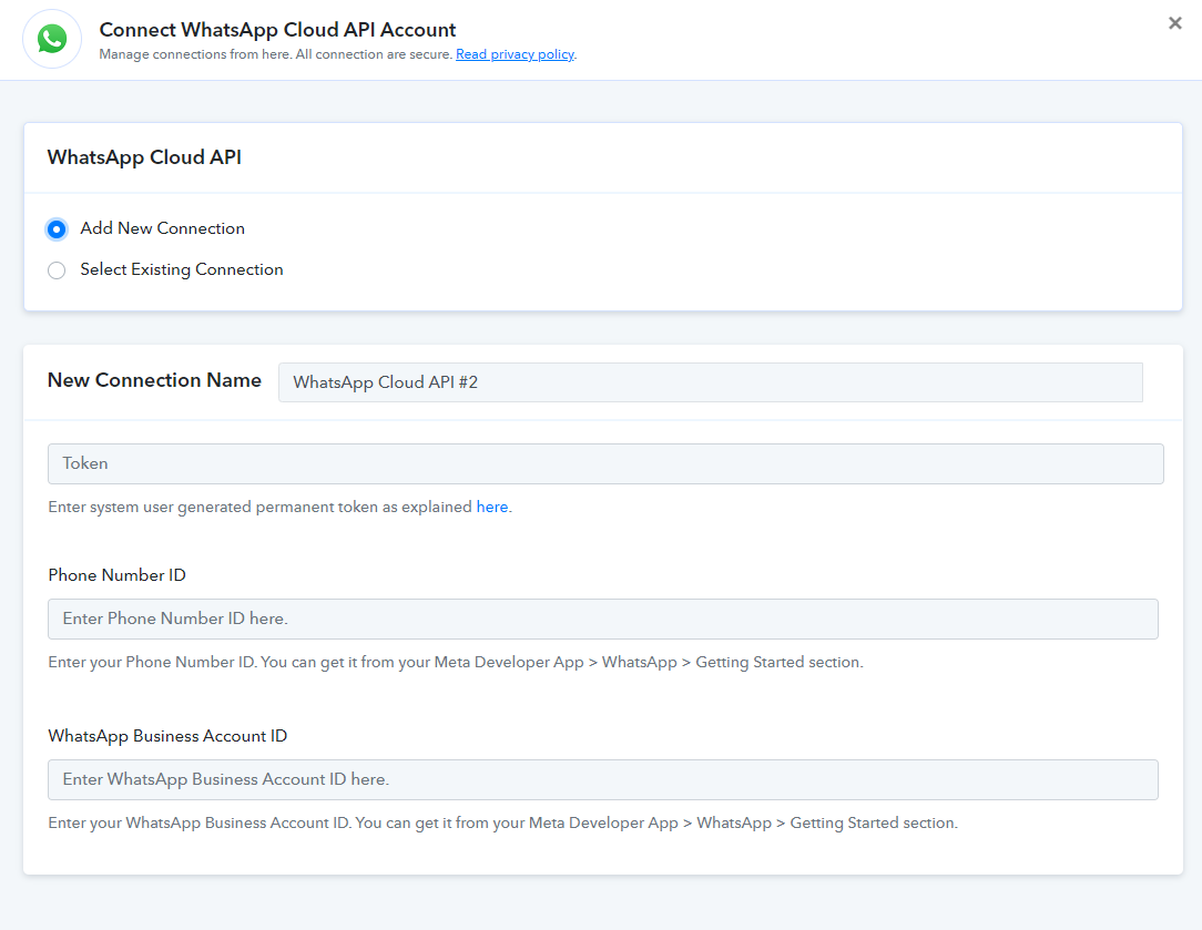

Supreme
Hey @jamesM
Can you try again by making a new connection of Cloud API in your workflow? As we are unable to regenerate a similar issue at our end.

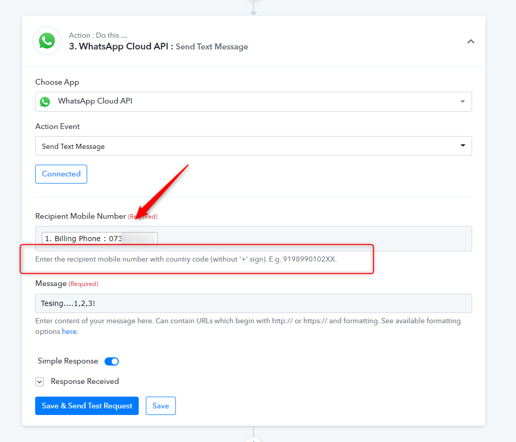

Supreme
Hey @jamesM
The phone number which you are passing in the "Recipient Mobile Number" field is not with the correct country code.
Kindly pass the phone number along with the correct country code.

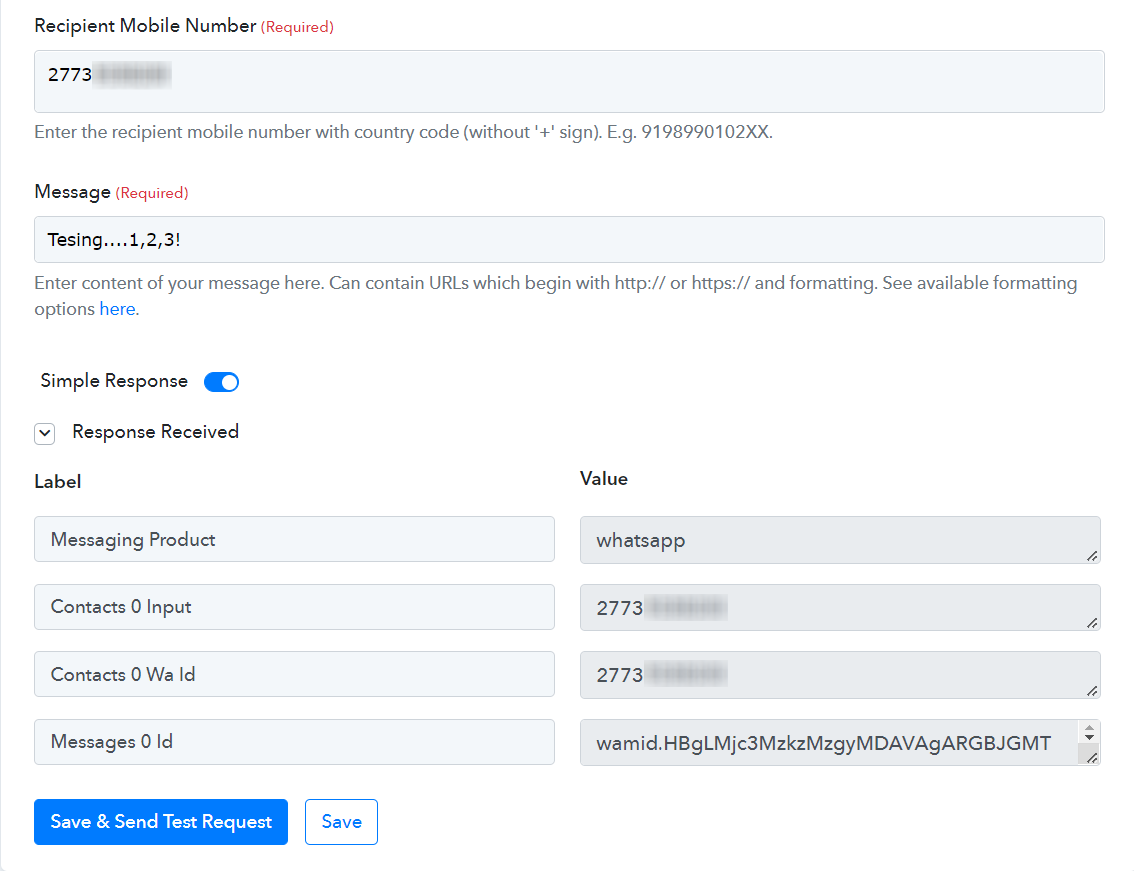

jamesM

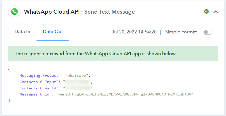

Hi @Supreme
I did try that previously and I got the same results again this time, no message received:
[{"id":"wamid.HBgLMjc3MzkzMzgyMDAVAgARGBI2RDREOUFBRjFFNDU2NUYyRTMA"}]

Subin
Active member
Hey @jamesM !
Thanks for the video recording, it was quite helpful to check on your concern.
"WhatsApp Cloud API: Send Text Message" will not send the data to random new users, as the previous conversation is required to send them the direct messages.
You would be required to use the template event in order to send the successful messages to random new users.
Kindly use "WhatsApp Cloud API: Send Template Message", it will work for you for sending new messages to random new users.
Hope, this works for you now.

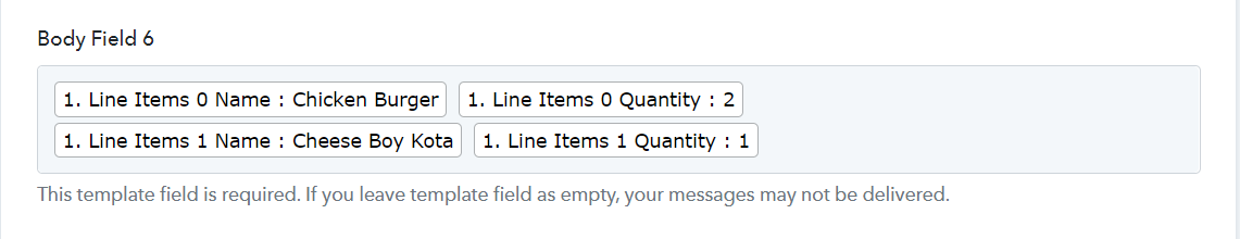

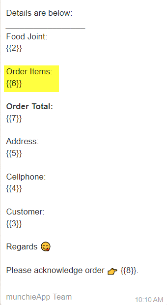

Seems that Pabbly doesn't allow me to send multiple data on a single variable, this is why my approach was to use the WhatsApp Cloud API: Send Text Message trigger and not the WhatsApp Cloud API: Send Template Message trigger.

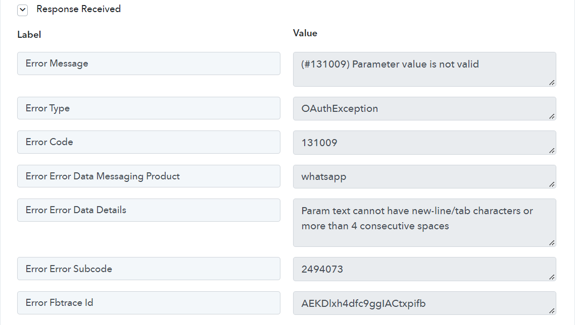

For example, what I mean is that when I have multiple order items in 1 order, these are not passed through and fail due to "text cannot have new-line/tab characters or more than 4 consecutive spaces"
This is my WhatsApp template:
Here is my template body field in Pabbly:
This is the error I get:
Error Message:
(#131009) Parameter value is not valid
Error Type: OAuthException
Error Code: 131009
Error Error Data Messaging Product: whatsapp
Error Error Data Details: Param text cannot have new-line/tab characters or more than 4 consecutive spaces
Error Error Subcode: 2494073
Error Fbtrace Id: AEKDlxh4dfc9ggIACtxpifb

Subin
Active member
Hey @jamesM !
The issue which you are receiving is due to the limitation of the WhatsApp Cloud API.
You can make a new template with maximum orders and then try to connect it within the workflow.
We can understand your concern for the multiple orders not getting added at the first instance in the template message, but as per the WhatsApp Cloud API, you would require to have a previous conversation to send them a direct message. If not, then a template should be used.
Hope, we have mentioned your query.
